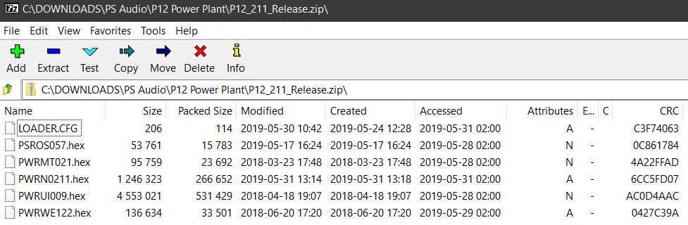

I just got a used P12 and it has firmware V2.06. I downloaded V2.11 and when I unzipped it, I got the following warning.
There are some data after the end of the payload data.
This makes me wonder if something in the zip file is corrupt, so I don’t want to do the upgrade until I can confirm that everything is OK.
Here is a screen shot from 7Zip showing the CRC values for each file.

Yes, I deleted all files that I had downloaded and unzipped, and downloaded the Zip file again, and got the same warning. I just checked the 4Gb SD card that was in the back and it is empty.

I did another test and the error does not occur when I extract the files with the Windows extract option. It only occurs when I use 7Zip to extract the files. However, I have used 7Zip for years and have never gotten an error like this, including on Firmware/OS updates for several other PS Audio products.

The files I got from Mark were not zipped. I used Notepad++ to compare each file to the ones that I unzipped, and they were identical, except for the first line in LOADER.CFG. The one I unzipped had ID = PWRN9998, while the one that Mark sent had ID = PWRN9999.
I believe that PWRN9999 in the file Mark sent me tells the P12 to load the firmware each time the P12 is powered up (called a forced load), whereas the version I unzipped should only load one time.
Having verified that the files that I unzipped were the same as what Mark sent (with that one small difference), I copied the files I unzipped to the supplied SD card and successfully updated the firmware to V2.11.
