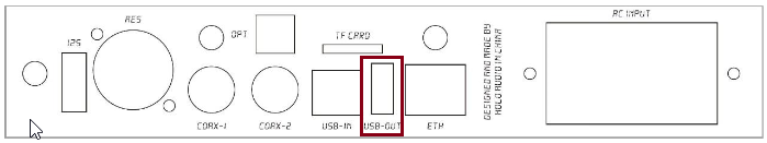

One end is plugged into the USB Out of the Red
The other is plugged into the USB Digital Input of the Mk2
There must be some sort of connection. I see the green led on the DAC. Also, while the Red is booting, the DAC displays 16/44. Once the Red has booted, I see --/-- on the DAC.

You don’t by chance still have the I2S cable connected do you? If so since it was the last output successfully used it will still have priority, so the USB won’t have a chance to see the Mk 2 and recognize the driver.
Solved! I had to cycle the DAC inputs from USB around to USB again.
Then refresh the Red. I now see the Mk2’s USB
Then enable in Roon
