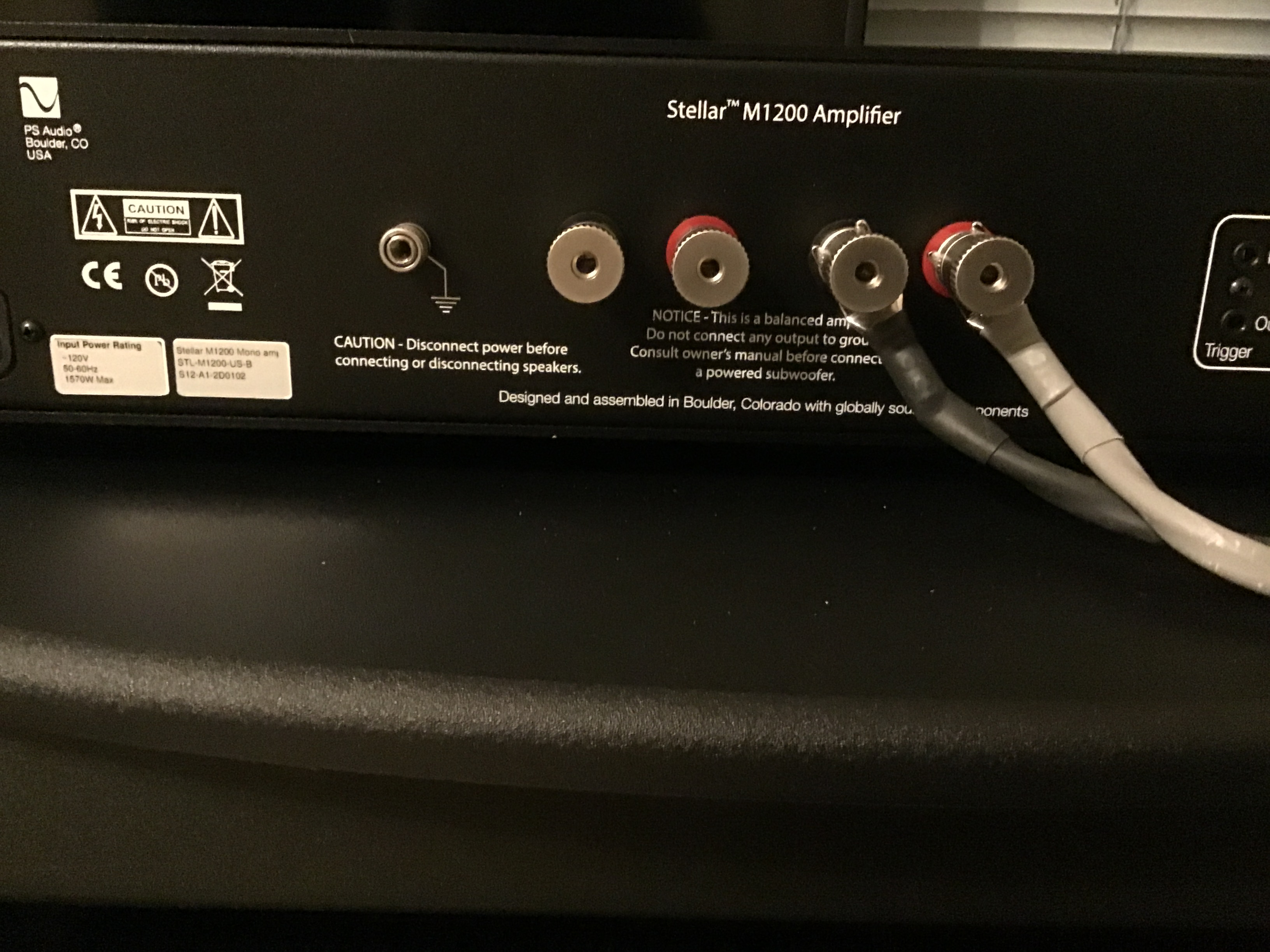

I’ve done both. Currently, Iconoclast spades. I have the cables pointed up like rabbit ears behind the amps. Works great for keeping them off the ground, etc.
The GCD is out for repair so I don’t have them in the system. But just for you I pulled one out and hooked up a cable. I don’t know how they compare to Iconoclast but pictured are Audio Art Cable SE2.
I can’t hear a difference between cables so I couldn’t tell you if or how spades or banana plugs compare. The binding posts grip the spades very well but I don’t like the way the cables lay unless they have room to hang over the back the the shelf or amp stand.
If unable to lay naturally by hanging off the back of the shelf the cable is forced to lay on the shelf. This tends to put the wires in a bind causing the wire to flex or fold at the connector. You can see a crease on the grey strain relief where the wire exits the connector. I have the same problem at the speaker connection (Spatial Audio M4 with binding posts close to the floor). For the reason of flex at the connector I won’t install the spades from the top.
Next time I will go to locking bananas but will also use a smaller gauge wire. I think the SE2 is about a 9 gauge equivalent.
Thanks a lot. I assume spade size is bigger than 6.3 mm looking at your pics, because the lug of the post is vertical and let small spades fit only vertically from top under or bottom up, not 45 degrees as yours.
Another issue in my question refers to using simultaneously a positive post both for speaker cable connector and REL wires yellow/red twisted. Now I’m going with bare wire termination and it reduces a lot the room for a spade if they need to share the same positive binding post of the M1200 (sandwich like so to speak).
The best solution, I suppose, is to use banana connectors for speaker cables and spade connector for REL cable, twisting yellow/red wires into one only spade (and Iconoclast can provide this termination as well).

Like the binding post set on the right side in my pic below (please do not consider the set on the left side, I’m just showing a test combining samples of banana and spade connectors for future cables)
For several months on the contrary I used to connect speaker cables to one set and REL cables to the other, as shown on the pic below:
Frankly I cannot hear any differences.
Please @jamesh what’s PS Audio opinion about these 2 different options, pic above or pic below? Or it doesn’t matter at all other than personal preference related to keep connectors better locked at our choice? TIA
