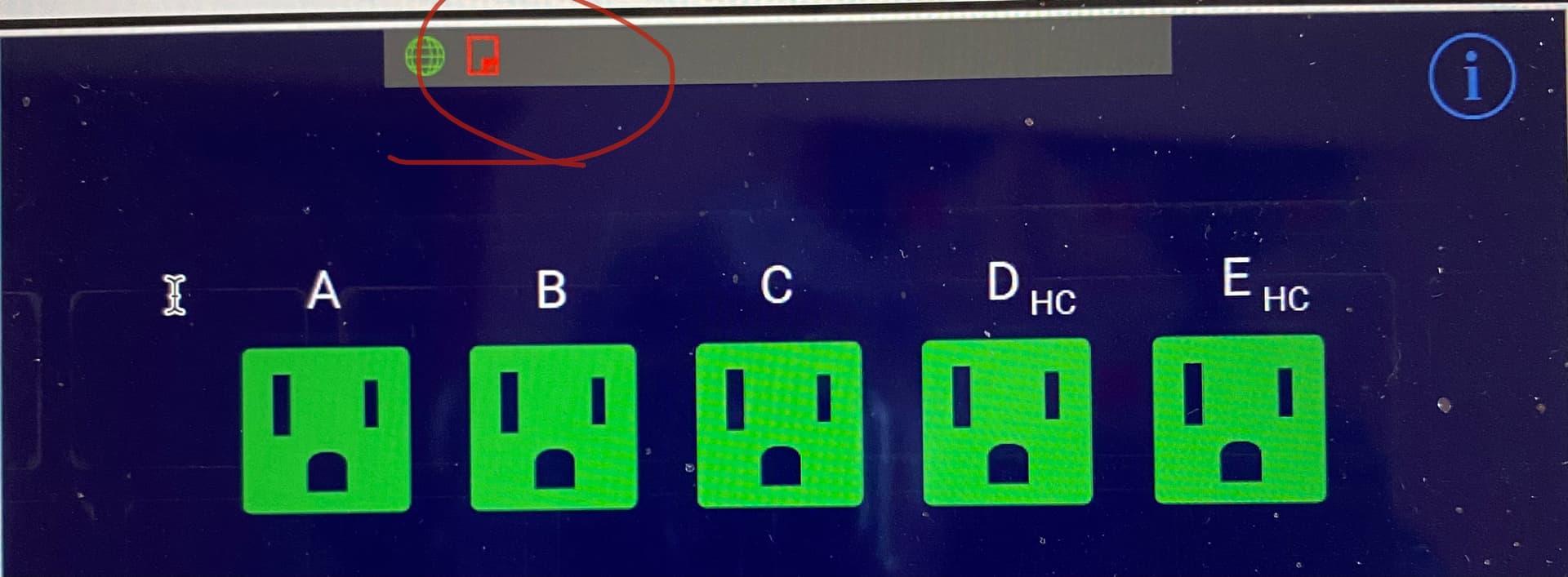

I turned it off, waited 20 secs, turned back on again and it initialized itself properly and seems to be ok after that. And I have a little red symbol at the top that looks like a document (see picture)
. What is that? Nothing in the manual.

My P15 had the same red symbol on day one. I never asked, but seems to me it’s an unused feature.
@jamesh…?
Can you provide an assist?
TIA
Mine has always had that with no effect
Mine doesn’t have that. I wonder if it’s specific to being network connected?
Yes, no cable plugged for me so world symbol is also orange
Super simple but that’s just telling you you don’t have an SD card in the back. The globe being green tells us you have it connected to the network.
