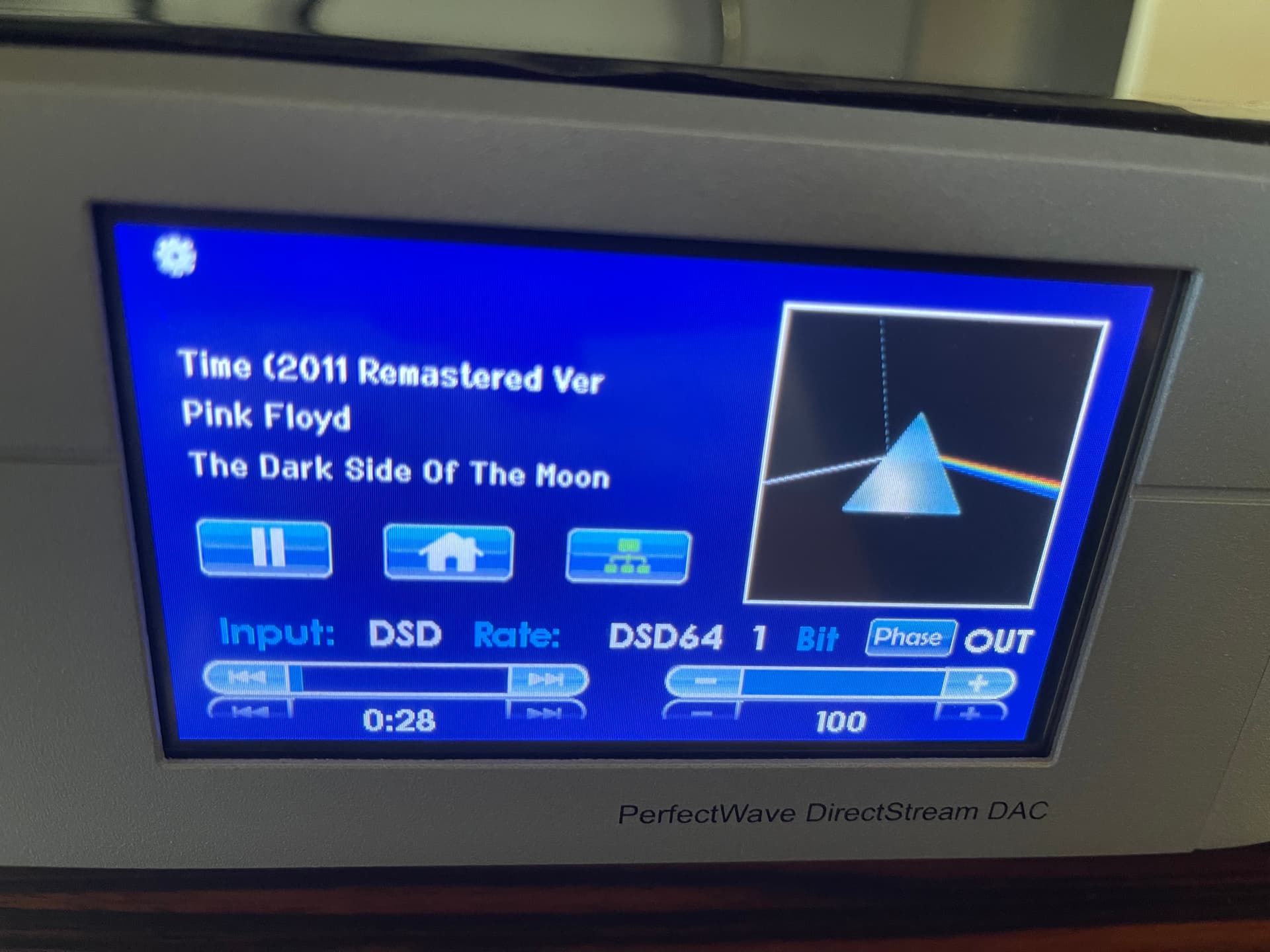

I have found my device but unfortunately no music comes out. The device shows me the songs but unfortunately no bit rate is displayed. Do you have any idea
Sooo i Dont know what i do But now i see this

Bridge II uses DOP to render DSD. Yours shows DSD input, which tells me the software is doing it wrong. Have you tried mControl or mControl HD?
Also, if the original DSD file being played is 128 or 256 some software apps won’t downsample it to match Bridge’s requirements (DSD 64)
Roon does it flawlessly.
