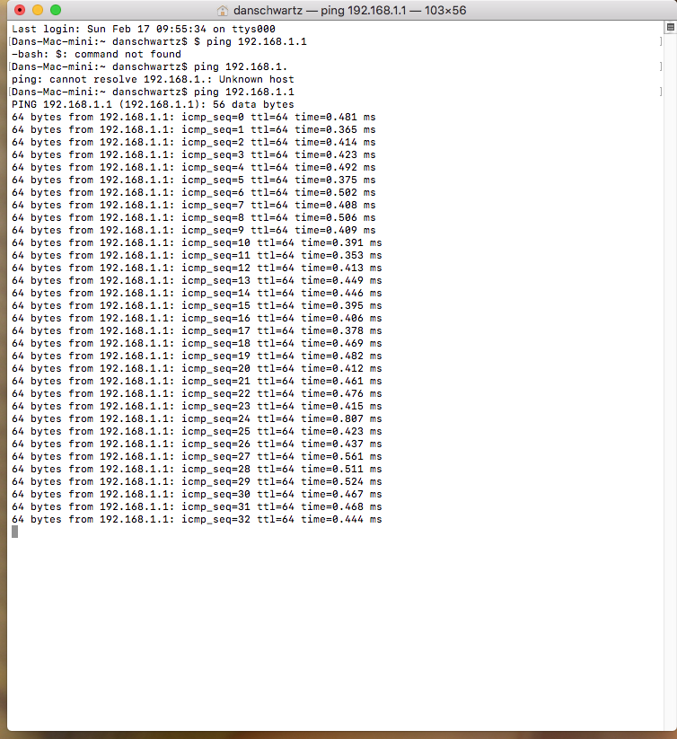

Looks like I couldn’t ping it.
19%20AM
Try:
$ ping 192.168.1.1
Your MAC is 192.168.1.4 and received this IP via DHCP. The default-gw for your network is 192.168.1.1. This is all good. The weird thing is you said your DS has an IP of 192.168.1.1 - this is the same IP that your MAC thinks should be the default-gw. The DS should have an IP of something like 192.168.1.5 with a default-gw of 192.168.1.1.
11%20AM
Shall I try changing the IP of the DS?
Don’t type the $ sign…
ping 192.168.1.1
But this is likely your router.
So shall I try changing the IP address of the DS? Might need some help with that.
If you turn your DAC off with the switch on the back, wait for a couple of minutes, and turn it back on, it should ask (automatically) for a new IP address. After it restarts, wait a few minutes and check the IP address. If it is unchanged and/or Roon can’t find it, post a picture of your DS screen that shows the IP addresses here.
