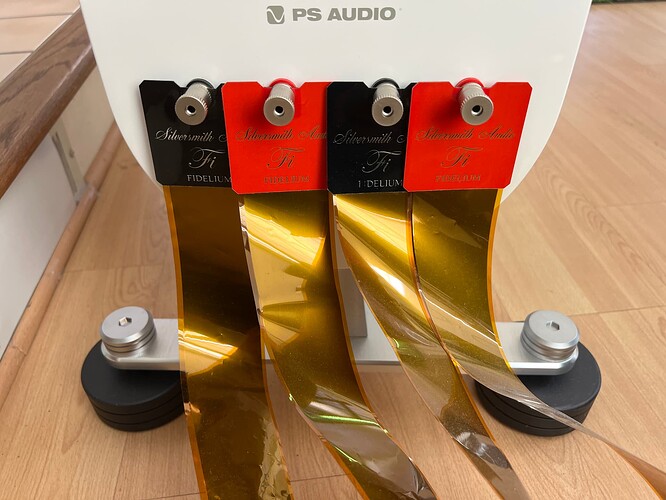

Fidelium SC connecting to PSA components very well, and I use two pairs with homemade cable lifters:
Very nice indeed!
