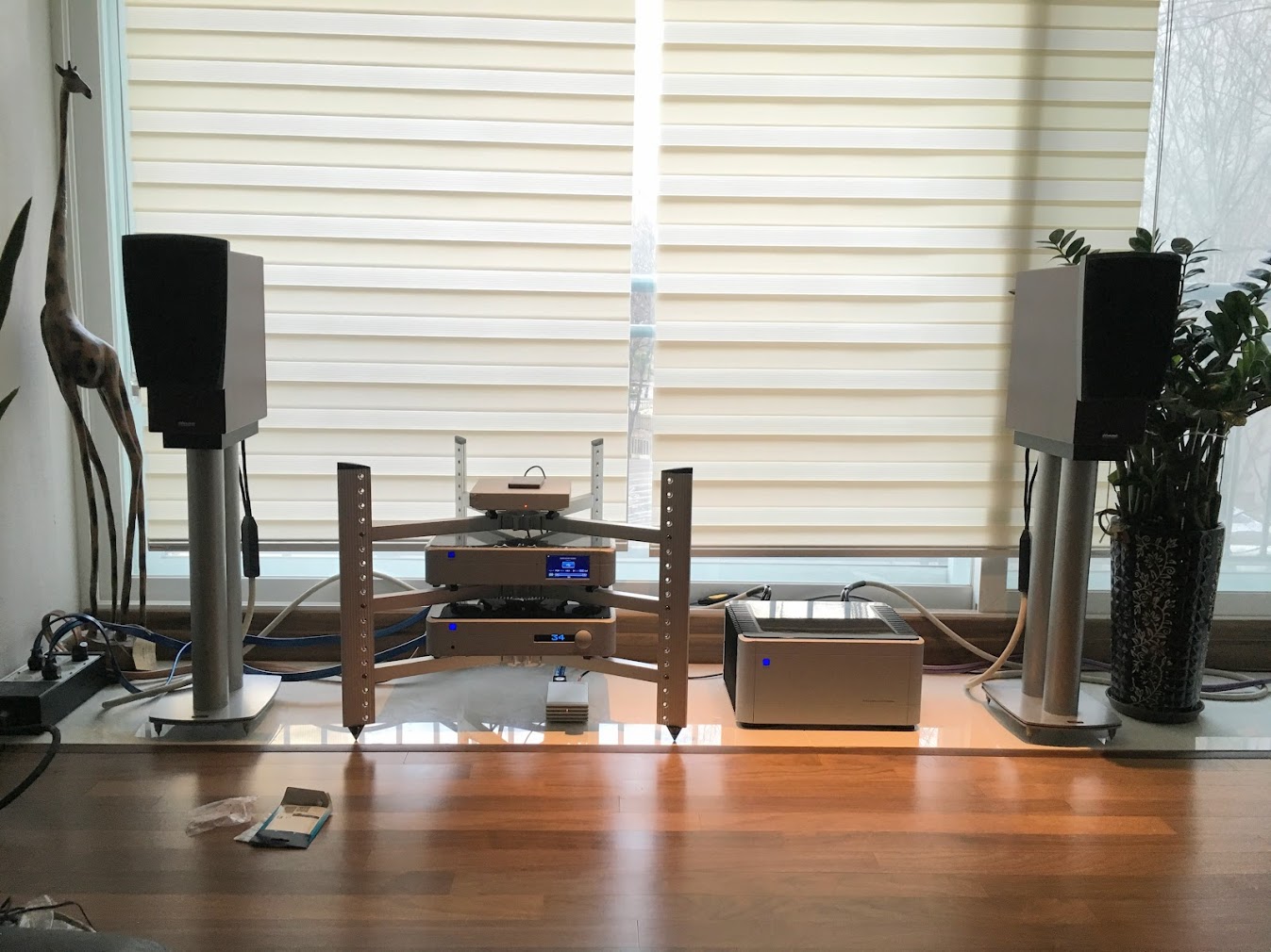

If you hav the money, it is worth every penny thumbsup
Get one of these. It was best spending I’ve ever made!
Get one of what?
Hats off Very fine stereo!
