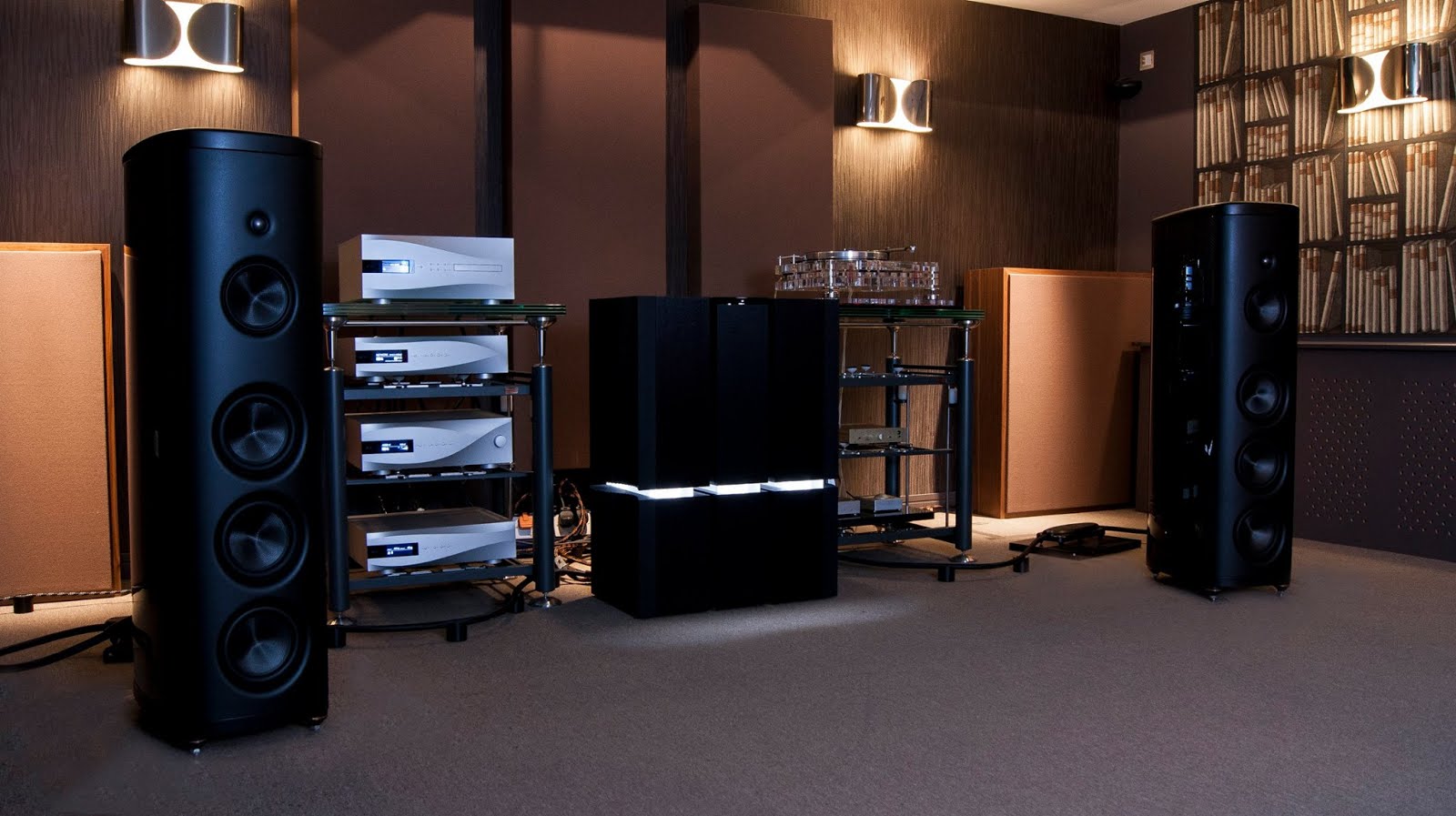

This was the modest little set-up we were listening to, with the reference Vertere turntable. Was the only pair of M3 in the UK at the time.
