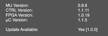

There is a major FW update available for MU2. You will like it. Tidal play and UPNP are available in addition to Roon now.
I quickly played a few songs and I love it, but I will let it run through the night to settle!
Interesting. I was unaware, but when I went through the menus via the web interface, I found:
Has anyone done the update process before, and if so, did it go smoothly?
I did it last night and it went smoothly. They also released updated manuals. It’s worthwhile taking a look at the software manual; especially the part about the Grimms now being certified Roon endpoints and the version of Grimm to enable and use in the Roon Audio settings.
