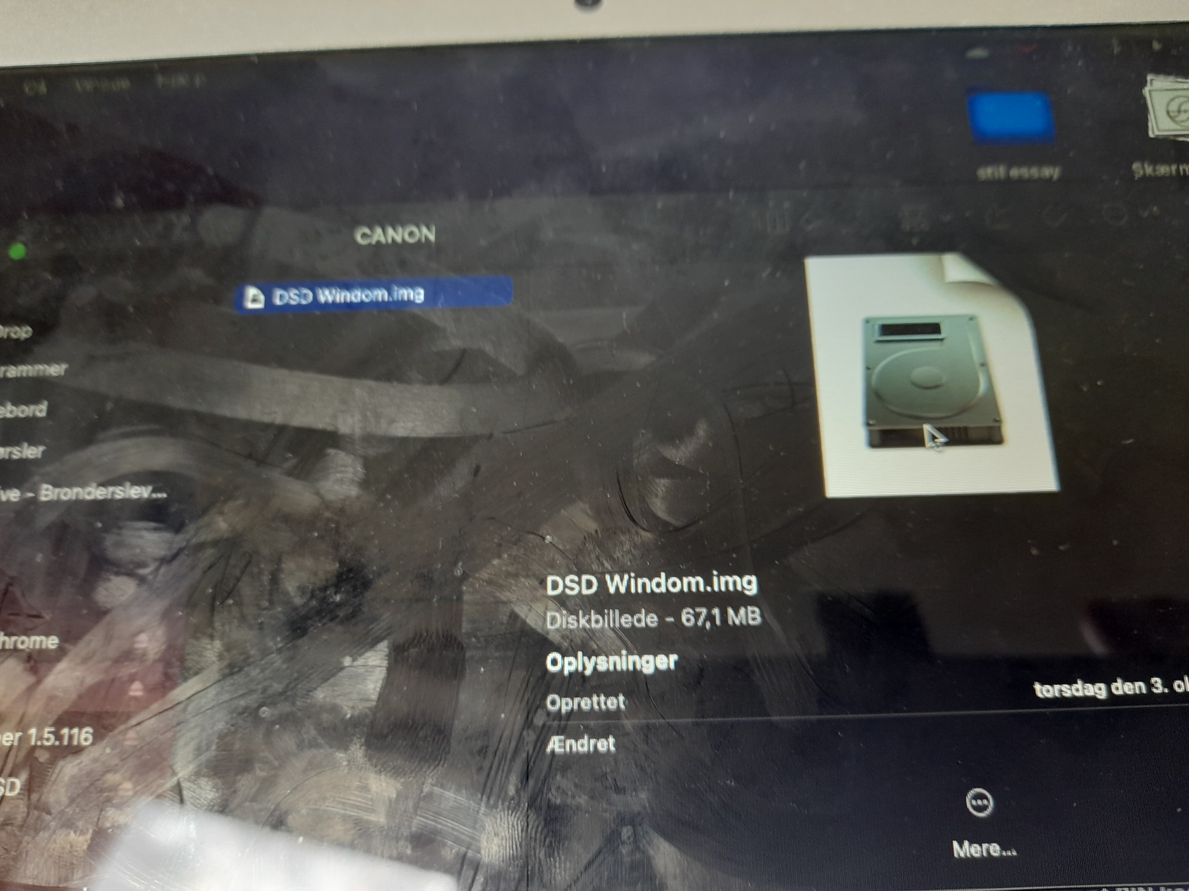

I unfolded the zip file and now I only have the file
DSD windom.img 67,1 MB
Is this right?
I tried to restart the direct stream dac with the new firmware , but nothing worked…

Hi
Does this look right?

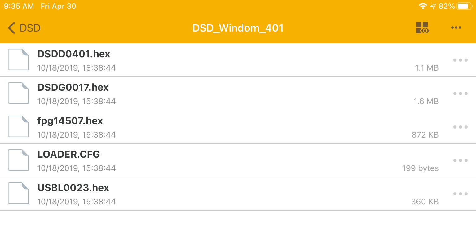

The image file has six individual files within it (including readme). They should be unpacked to the SD card.
Do you use Mac or PC? On my PC, I have these files:
Thanks Terrence
Hi
I use Mac
fre. 30. apr. 2021 16.42 skrev Terrence via PS Audio <psaudio@discoursemail.com>:
Is there a utility to on mac that allows you to see and copy the contents of the image file to the SD card?
