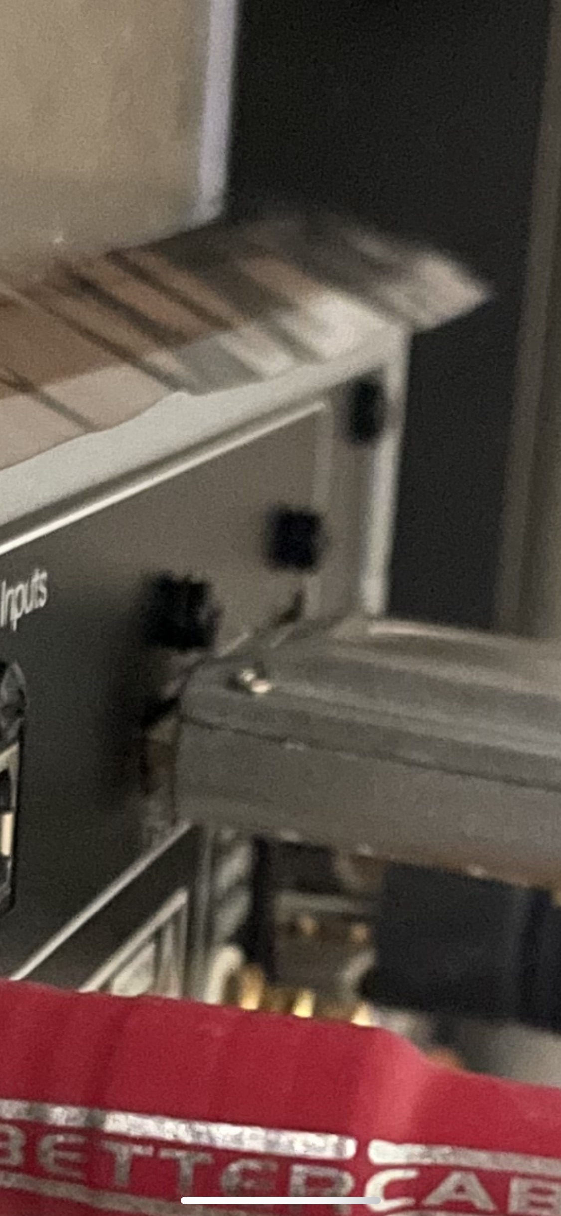

So I guess the website isn’t working. I’ll have to call or email tomorrow. But I received my MK2 last weekend and indeed it is a big improvement over MK1. Sound just explodes in all directions front back left right. Wow!! I have an issue which disappoints me however. I went all in on I2S via HDMI way back when and currently own a Tubulus Concentus for this purpose. However the Tubulus connector is large enough that I can’t get a good connection to the I2S input on the back of the MK2. There are huuuuuge screws on the back panel that block the cable’s connector body from full insertion. I can get a connection using I2S #2 but it is not a snug fit. I2S #1 I can’t get any sound from at all. Wonder if I can change to flathead screws.
You could always hit it with a Dremel grinder the HDMi connector add a bevel or the screw head. or little of both
Good ideas.Thanks
If it were me I’d do the following:
Contact Support, explaining what the issue is in detail etc…like you did here. They’ll enjoy getting this data.
Ask for the specs of the screws, if they have flathead replacements. If not, get some at any hardware store.
Replace one screw at a time. Doing so will minimize the chance of disconnecting anything on the other side.
Just talking about taking a Dremel to a brandy new piece, of anything for that matter, gives me the willies! Although I’m diggin the idea, just not on a new toy.
I suggest you replace the screws with these:
They are referred to as “Low Wafer Head Machine Screw”.
They come in philips, hex, star, and square drive. They may come in slotted, but I am opposed to slotted.
I will contact them tomorrow and ask about screw replacements. I did verify I2S #1 is working by replacing the Tubulus with a PSA i2s/10. Funny the Tubulus can connect to #2 but not #1. Must be a very weak connection.
PSA may be closed tomorrow. It’s Martin Luther King Day, a federal holiday.
Wondering if I could swap screws with the MK1 which has not been boxed up yet. But I think it is best to wait and see what they say.
No matter what, it’s good feedback for PSA. This can’t be the only HDMI cable that’s going to have issues.
