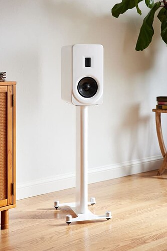

The units are in mass production now and we should be launching the website soon which will have product information and release dates etc.
Here are a couple of teaser pictures from the product photo shoot that we just completed.
Hi Chris, stunning work and nice photos. It is very probable these are my future speakers! Can’t wait.
