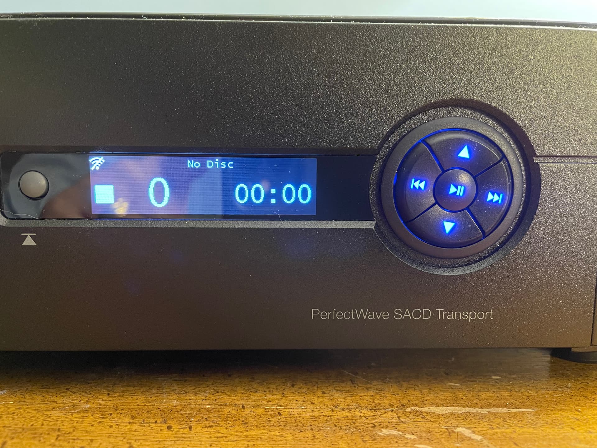

I do have the door closing clunk and the control ring is a bit off:
But otherwise things have been great Though I must admit with the PST on a north-south axis I have a strong instinct to center the gyro compass:
The PST is definitely a clunker! That was the first thing I noticed about mine. I would not put up with the rotated switch ring. Hopefully they can fix that and the issues with playing the dsd layer of the disc you mentioned.

I do find the PST transport mechanism to be picky with the placement of the CD in the drawer. It is not forgiving if a CD is placed slightly off center, so occasionally I get the no disc message. The problem is easy to resolve, so I try to be very careful when inserting a disc to prevent this from happening.

The control ring would drive me nuts.
You mentiond placing a cd off center in the drawer. I do not like the very shallow rounded provisions for the discs. It is too easy for a disc to slide out of position when the drawer is closing. Both the DMP and the original PWT had much safer trays and they did not clunk when they close.
You described the issue better than I did. The drawer is too shallow compared to most CD players. If the disc is not perfectly seated, it will not read the disc and you get a no disc error. It happened to me a number of times when I first received it. I have just learned to be sure the disc is properly seated before closing the drawer.

I do that, too. I’ve had one “no-disc” error, and my lazy self tried to get it to fix itself by repeated opening and closing of the drawer from my listening seat, via the remote, but no luck. I had to actually get up out of my chair and walk across the room, if you can believe it! :wink: Ever since then, when I put in a disc, I kind of shuffle it around in the tray with a finger to make sure it’s sitting in there correctly.
